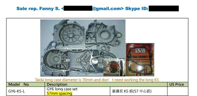

I haven't cruised their whole site yet,,,I don't know if I would want to do a BB build on Chinese cases,,,I'll have to research it,,,you will be the first to know when I'm ready as I will source parts only from you,,, now I need to find a victim,,eeeerrr I mean bike I can work on with a decent chassis,,,probably be a sym or kymco ,,I'll see what presents itself,,,,oh and just by looking at what's entailed with this kind of build,,,I would think I'd be lucky to pull it off for a grand,,and knowing me it will take more than that to get it done It may be a Chinese case, but don't forget, Honda was the one that designed this engine and it has been in production for over 30 something years... I kind of liken the GY6 to a 350 Chevy when it comes to parts to availability... What I mean by that is they're a dime a dozen and the parts are every where.... I know what it is you like about Kymco, I'm a big fan a Taiwan products too. Taida products are all Taiwan products... When I gave the Lambo/Camaro analogy, it even holds true on pricing. A Taida engine will set ya back some, sure, but if ya want the best, you have to pay for the best... Some of the great things about Taida, everything is top notch, Taiwan B-blocks with oil port in the r crankcase, all BBK's have option like ceramic coating, forging / high compression, strokers are balanced with their corresponding BBK's, TPI bearings, NJK seals, everything is top of the line Taiwan products... In my 232cc, nothing was made in China, not even my block. (Taida has their own blocks) ... You can not get more Taiwan than Taida. When the parts arrive, you can just tell how much higher the quality is... While they're not polished, they're nice and shiny and every part is engraved with the Taida and Taiwan lettering... The blocks come bare ... No bearings, bushings or seals... This is awesome if ya want to powder coat the engine..... ------------------------------ Another nice Taiwan Kit is 180cc Power kit the PFS sells... You need a donor motor but it's right around $450 and you can catch it on sale for cheaper... It's a decent kit...
Post by cyborg on May 18, 2015 9:34:33 GMT -6
I didn't see cases when I went to taidas site,,, I'll look again,,, I want very good quality and don't want to do a nutty build on a Chinese case,,, they are not up to the task

I didn't see cases when I went to taidas site,,, I'll look again,,, I want very good quality and don't want to do a nutty build on a Chinese case,,, they are not up to the task GY6-KS-L (long case) GY6-KS-S (Short case) ![](http://i109.photobucket.com/albums/n78/kellmarr95/Taida%20Long%20Case_zpsthzaiige.jpg~original)
