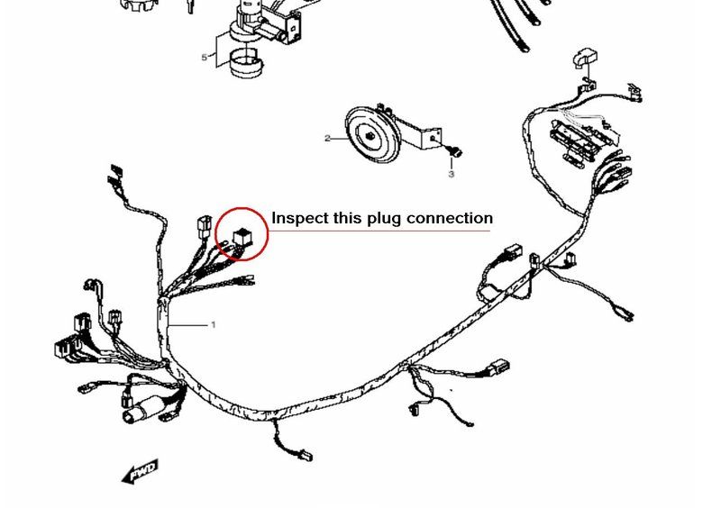

Im not 100% certain, but like 95% certain that what I highlighted is the plug that connects your main harness to your instrument cluster.... If that comes unplugged or interrupted, it will kill all the lights to your instrument cluster... Most of the time it's a 9 pin plug, but taking out the ground kills the whole thing... Have you verified the other filaments in your turn signals aren't damaged like brake light? These style of bulbs get taken out easy, but not the instrument cluster ones... They have tiny filaments and are pretty durable....

He said his dash lights are out too... While it could be the case that every single filament on every single bulb was damaged, I doubt it.... MY guess is that your lighting circuit(s) isn't getting charged... When the scoot took it's spill, either some wires were damaged, or a connector came loose is my guess... What is your exact scooter model, and year, I'll see if I have a wiring diagram and highlight the areas to check. The scooter is a 2004 United Motors X-Peed 50. I found a really good manual but I have not found a good wiring diagram yet.... Yes, it could possibly be your R/R, some scoots also have a separate light relay.... Here's a link to the manual (This is a 2005 but I bet a lot of it is real close) I wish I could find a good diagram for this scooter....

So somebody wrecked my scooter and now the electricals don't work (headlight, taillight, blinkers, fuel gauge, dash lights, etc.). What should be my starting point on fixing this problem? Thanks! If you checked your main fuse, here's what I would do.... These scooters come with 3 harness's pretty much... One for the instrument cluster, one that goes on your frame ( your main harness) and one separate one for the rear bulbs.... If all that stuff went out in the crash, the first thing I would check, is the connections between your instrument cluster and main harness. Maker sure your connections are good... Unhooking those will produce the same symptoms you describe.... After that, I would do a visual inspection of the harness for areas where is was squished/smashed in the crash.... (Does your kill switch and start switch work??)
