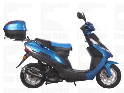

Hello Dear 2wheelers monsters and geek squads! Here I need your help in looking into the problem of only one spring shock damper this model is limited to by manufacturer! its Chinese PMZ50-4J 49.5cc scoot however modest one but so far my only transposition vehicle. ![](http://www.icebearatv.com/pimages/pmz50-4j_73604_400x400.jpg) However I've found myself there is still a binding welded in to the frame at the right side where the muffler is at. So I suppose there will be still a possibility to upgrade a bike by safety sake with an additional spring air shock damper? As for example one listed in here, air shock damperI've got a lot of concerns as well a spindle axle's load and whatnot... Please feel free to share with any hints to give me a clue! Thank you all in advance,

We've seen a few threads about this issue in the past,,,pricey to do and hard to source the needed parts

We've seen a few threads about this issue in the past,,,pricey to do and hard to source the needed parts With the pretty reasonable prices for air shock about 25 bucks it doesn't make the whole enterprise that flippant, so far and the choice of parts is pretty much lavish. the question still is if somebody could brag with real experience in such update? For me I suppose to apply the following scheme in order as well / - a swing arm 13 in { \ - and air shock damper 13 in

Seems like all 60s come with one shock. I'd just get a perfoemance one, surprised to hear that adding a second one is so pricey, could probably do a rear disc for about the same cost.

There have been many millions of scooters made with only one shock. Apparently it works for most of them or we would have heard more about it. If you have binding on the right side it would be good to correct this and then see how it rides.
You may have a bent frame and adding another shock probably won't unbend the frame.
God only knows how many videos I have watched with a whole family riding on one of those 50's. Of course the shock must be bottomed out with 5 riding on it!
